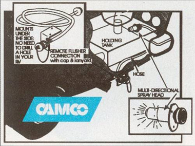

Hi, Mark,
What is the best way to flush out the galley tank and the grey-water tank? The black tank, you can pour water down the toilet. Do you do the grey water & galley the same? It would take a while filling the two tanks that way. Also, do you put a chemical in them?
Tom
Hi, Tom:
Probably the best way to effectively flush your grey tanks is to add permanently mounted tank flushers to them. These flushers are great for the black tank, too. They will simplify the flushing process greatly and keep your tanks clean. Check out
www.rvtoyoutlet.com/c-rv-tools-008/p-RV5834.html
for an example. The diagram below from the Camco Quickie Flush instruction sheet shows details on how the flusher is typically installed. These are a great add-on gadget, and the kit is easily installed by the average do-it-yourselfer if you can access your holding tanks under the rig or through a compartment. You normally won't need chemicals for your grey tanks, especially if you flush them out regularly.
